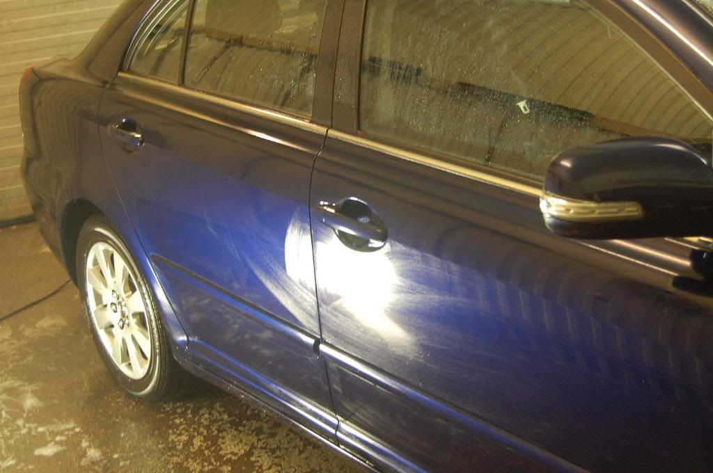

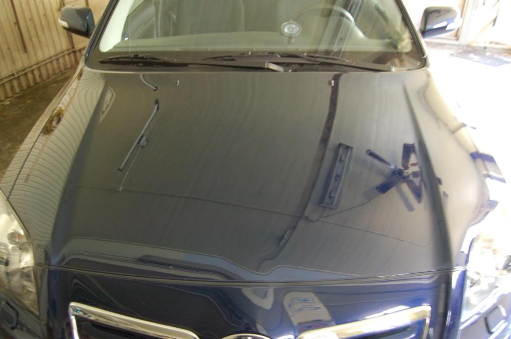

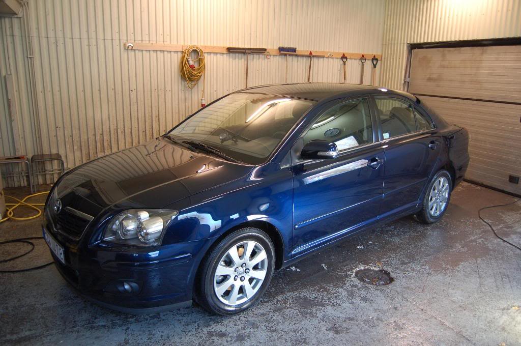

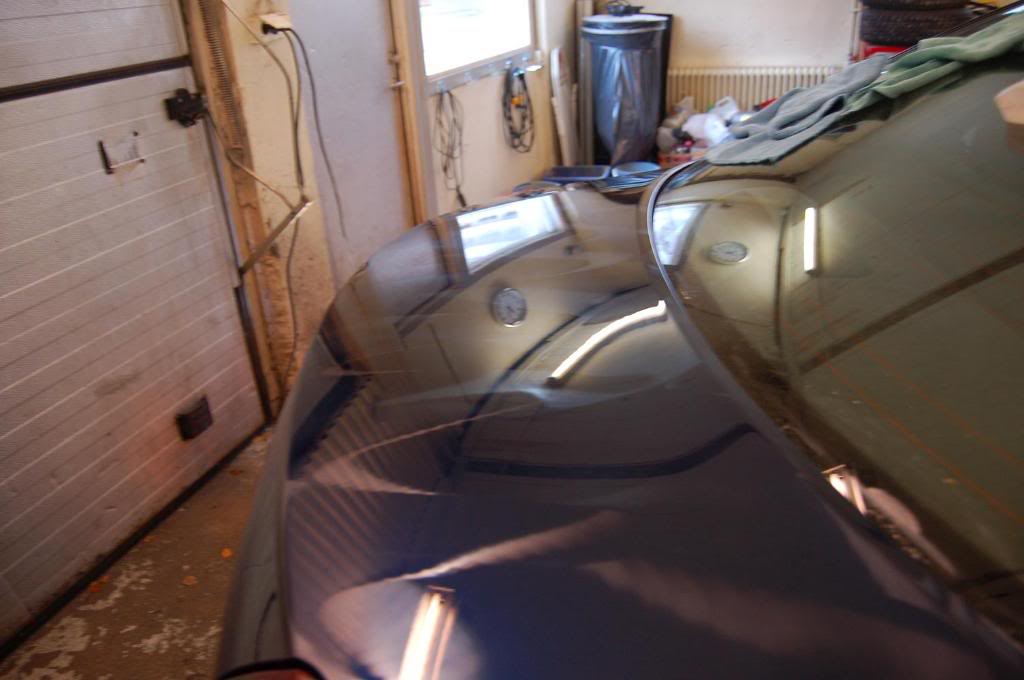

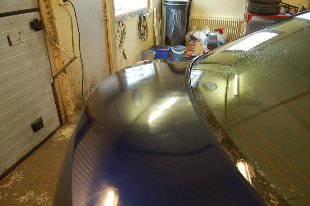

Toyota Avensis -07

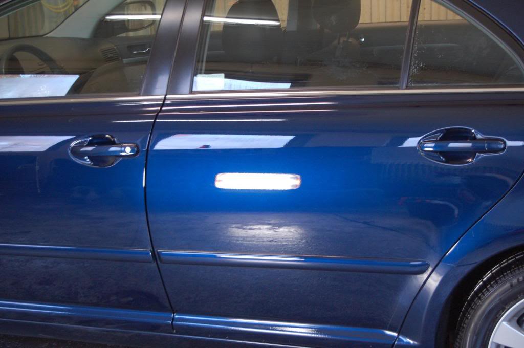

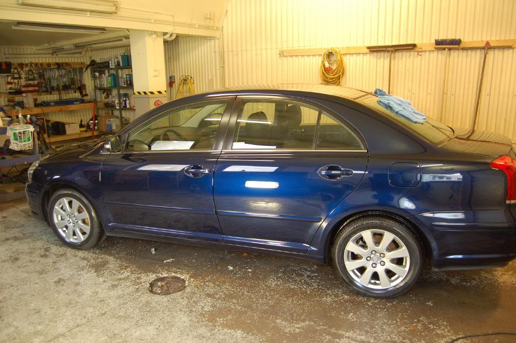

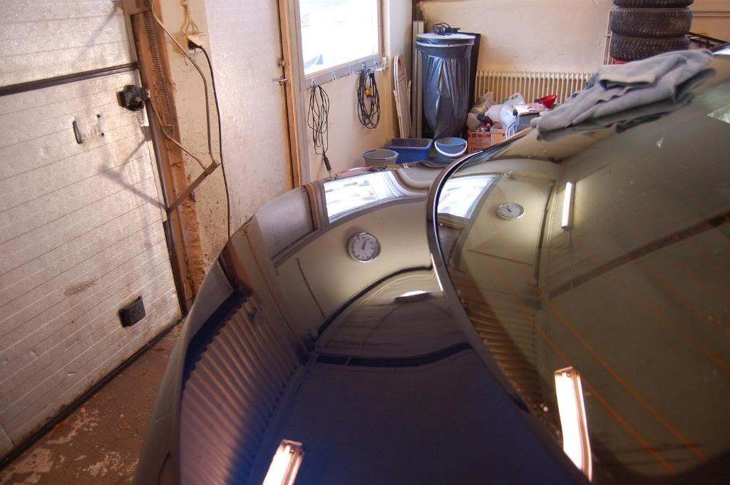

No so many before pictures but the car was only a year old and swirled to hell. The owner uses fairy and a old sponge to wash the car :shocked

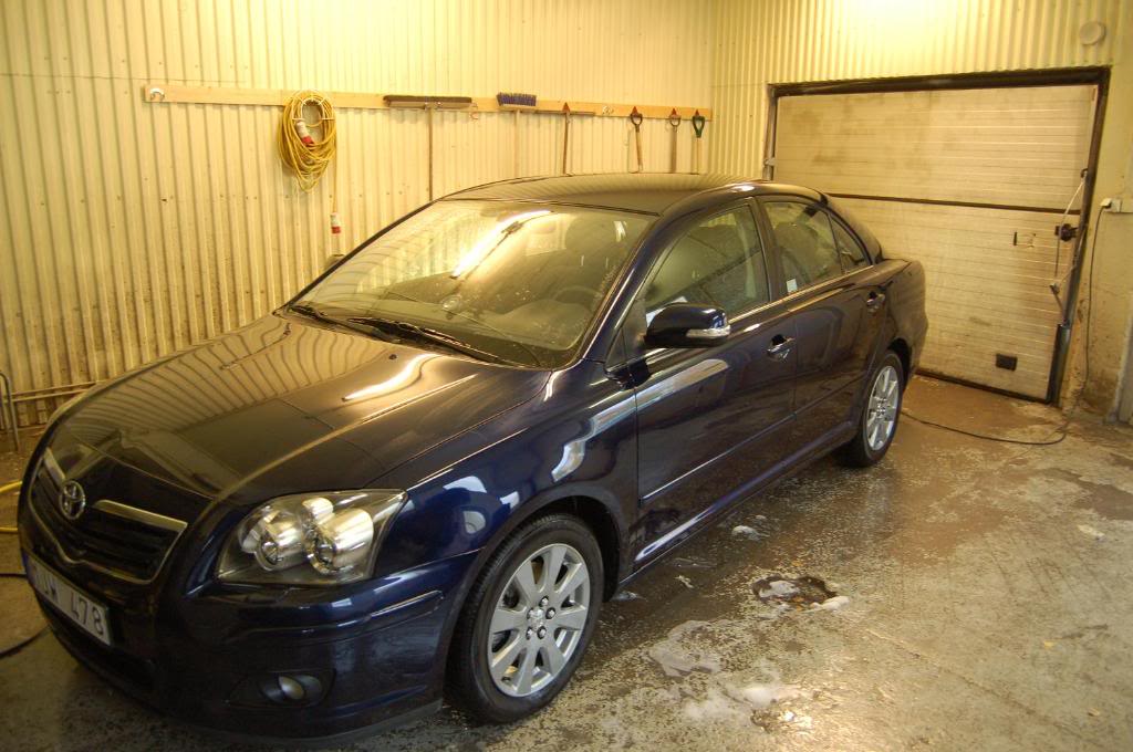

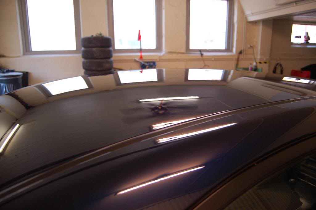

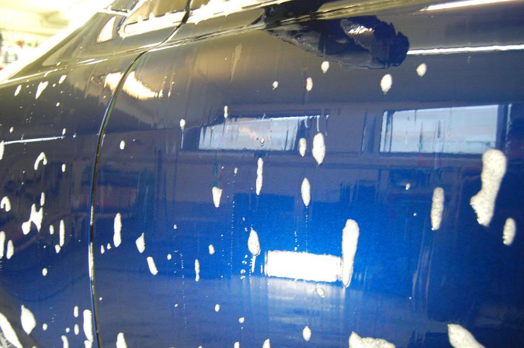

Cherry foam mixed with alkalie degreaser to clean the paint before applying LSP
After wash, no LSP

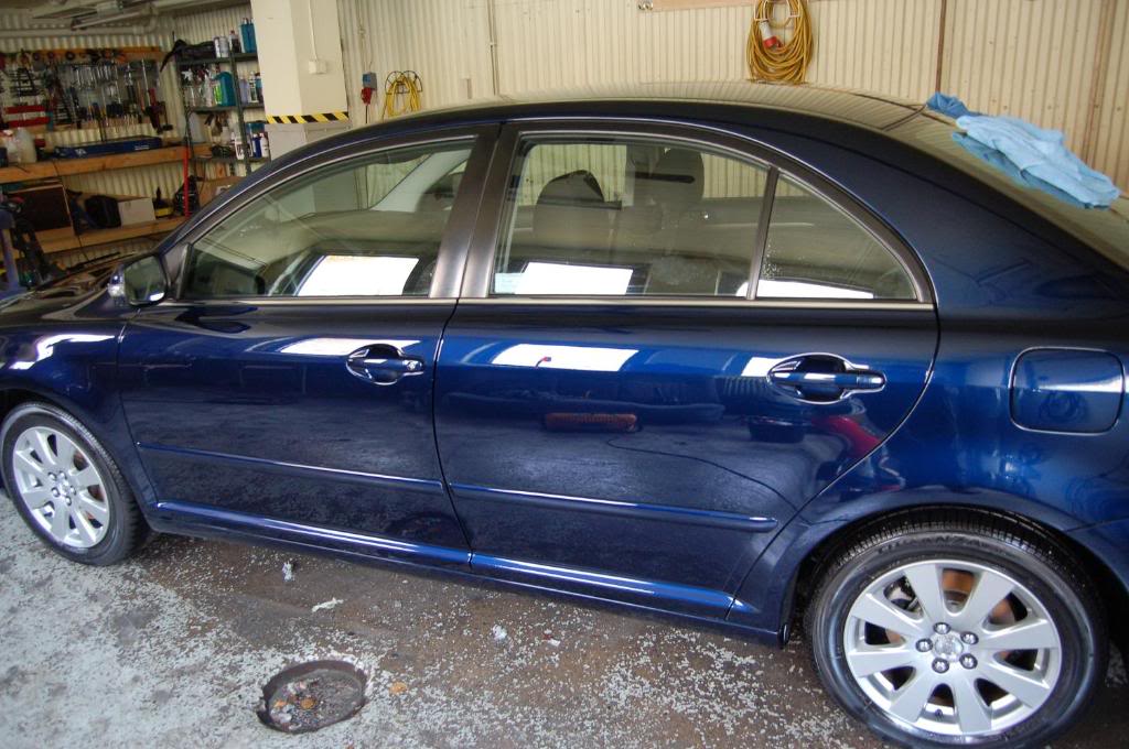

LSP curing
Mixed afters

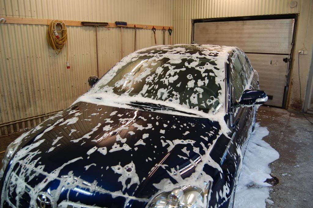

Wash
Heavy alkalie degreaser, cut 1:25 with water
Cherry foam
Clay block, using cherry foam as lubrication
IPA/H2O wipedown

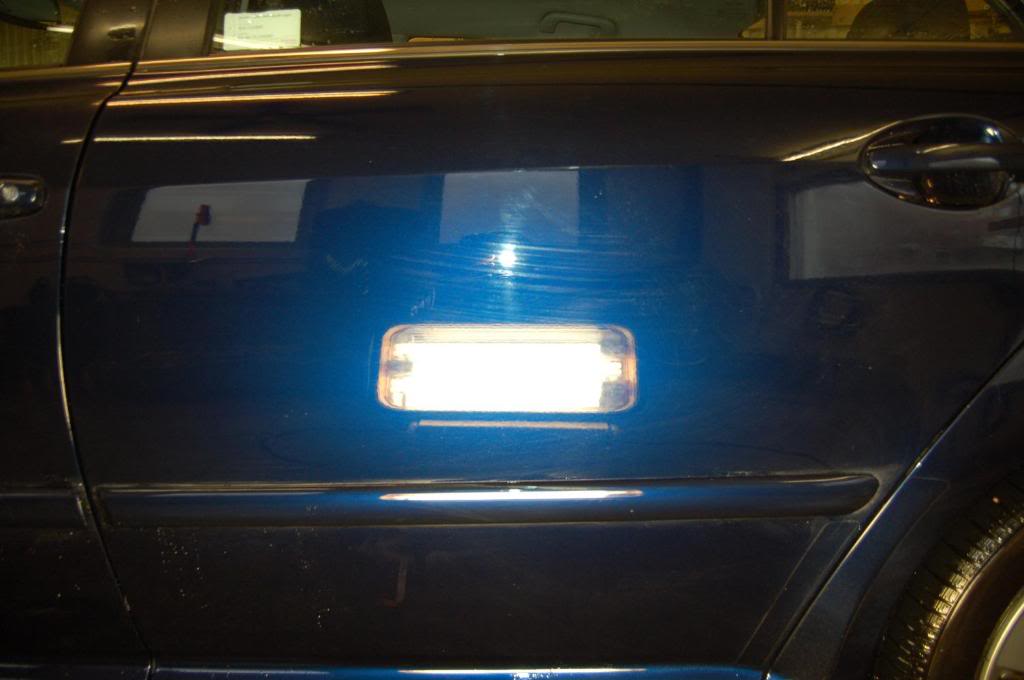

Polish

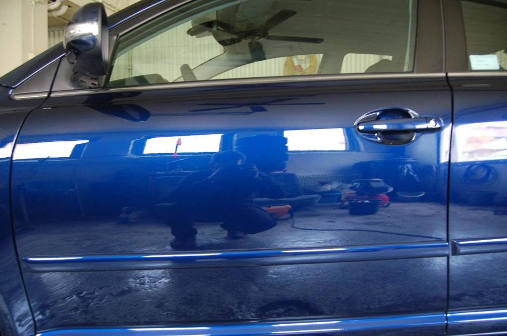

Menzerna PO85RD3,02 with new purple coloured pads - Top tool
Menzerna PO85RDRE5 with black Mirka finishing pad, rotary 900-1200-1500-1800-2000-2500-1500-900 (IE zenith) must say that I love to polish Menzerna @ higher speeds :woot2: Each step was removed with a new Microfiber-towel and paint wipedown with IPA/H2O

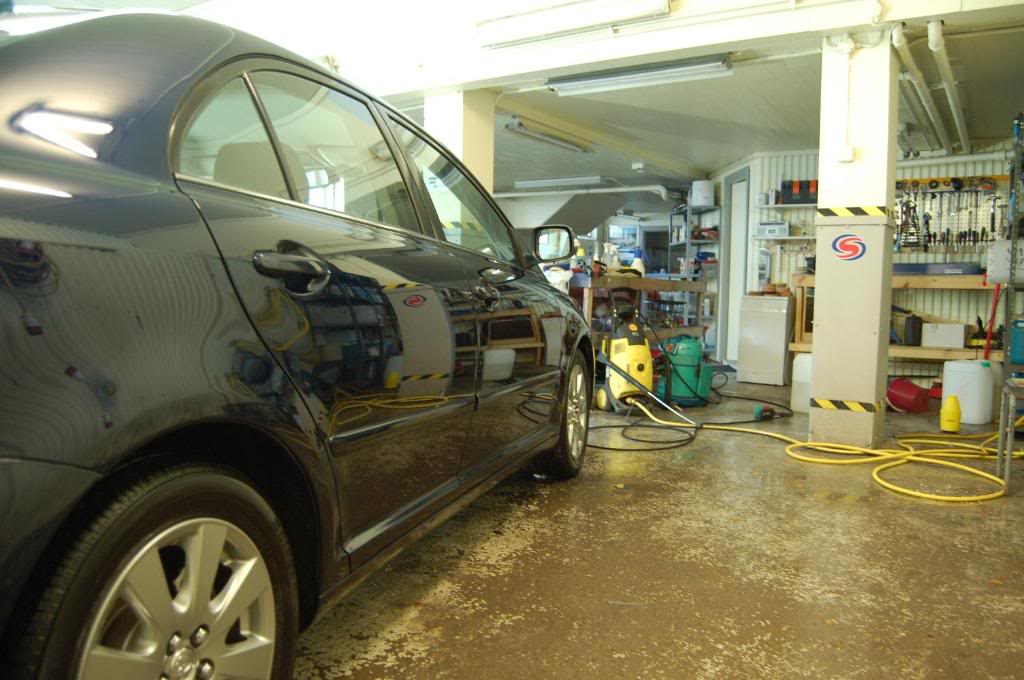

Second wash
2oz cherry foam blandat with 3oz heavy alkalie mixed with ~16oz of water via foam gun 1:10. Foamed twice. Rinsed with pressure washer. Dried with soft waffle weaves
LSP
A new sample. Applied with a small Microfiber-sponge. Let cured for about 30 mins. Removed with a damp Microfiber-towel and a clean Microfiber-towel for second buff

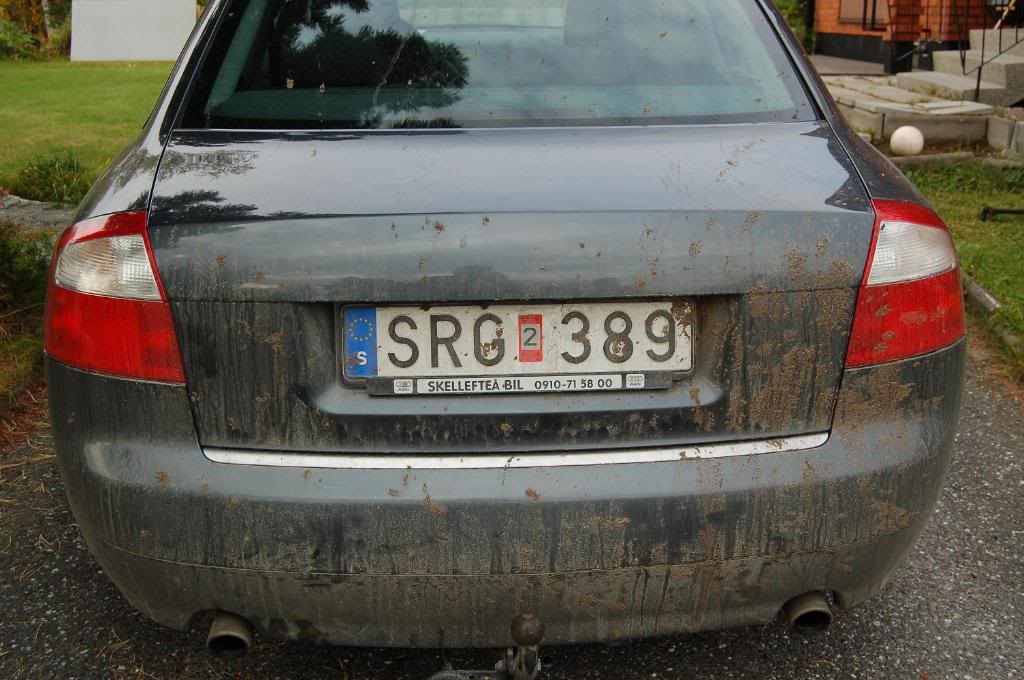

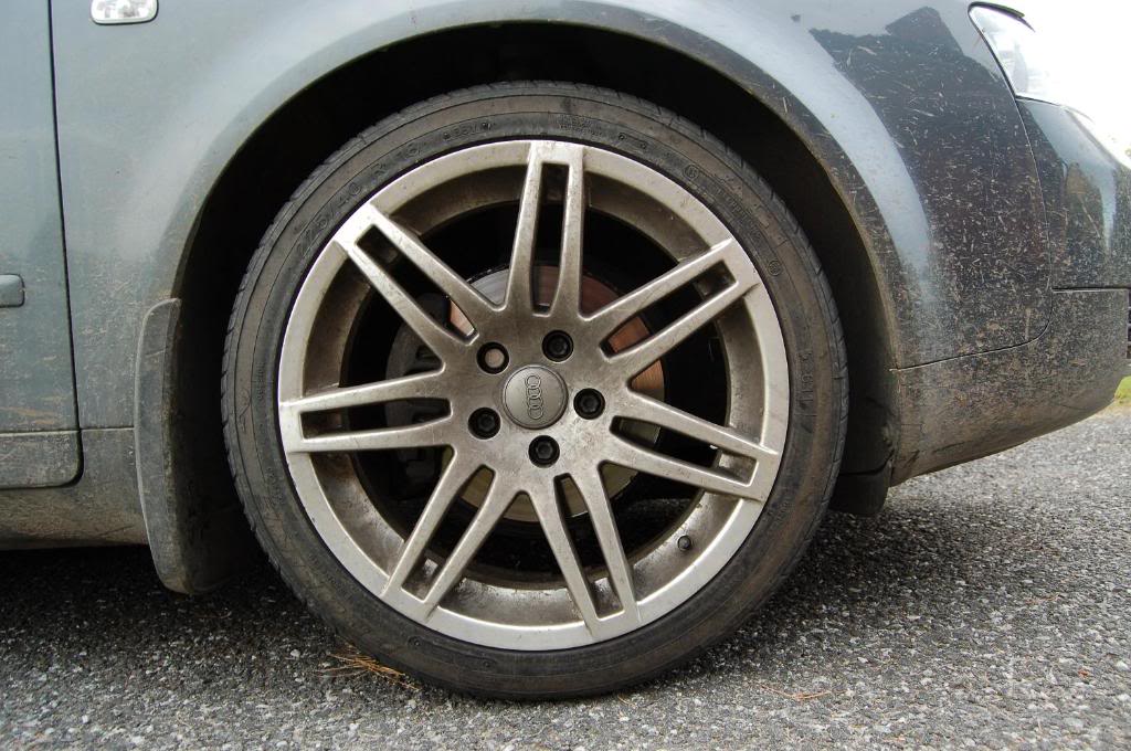

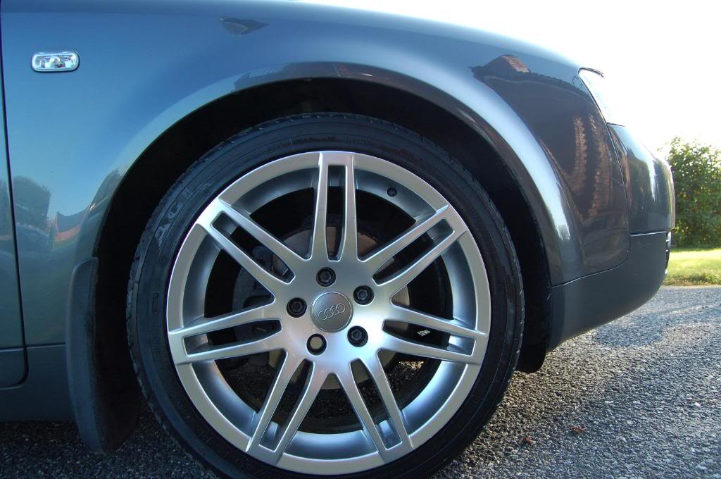

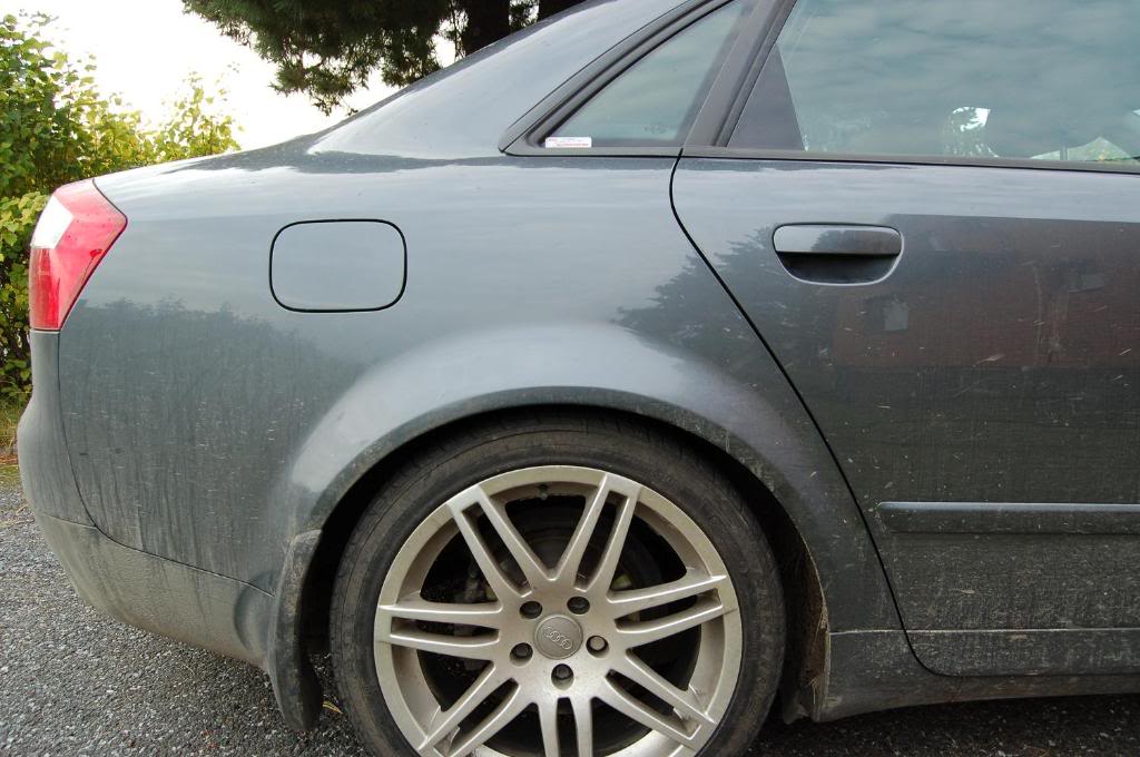

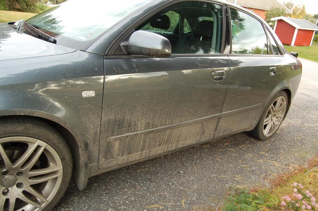

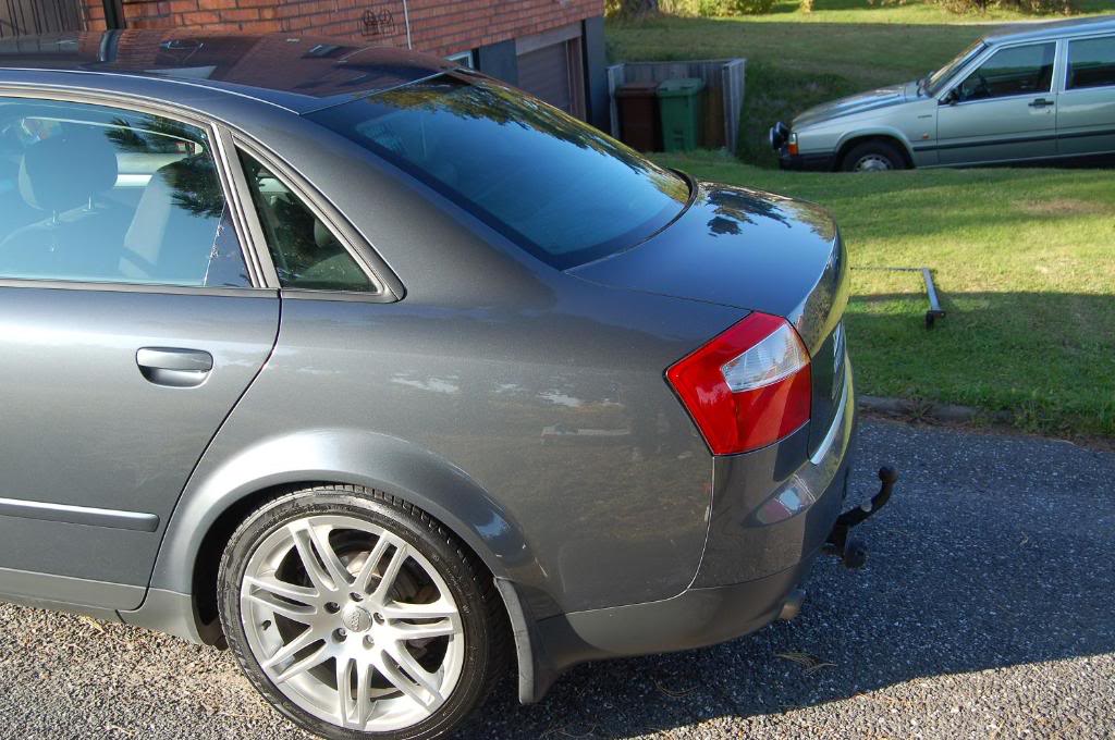

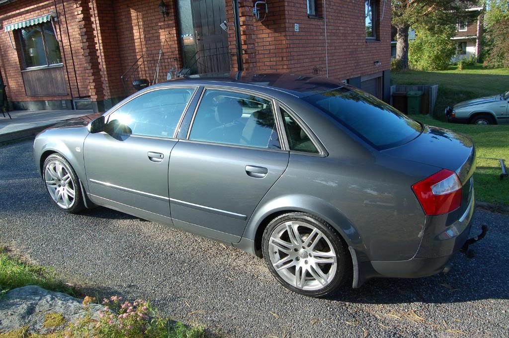

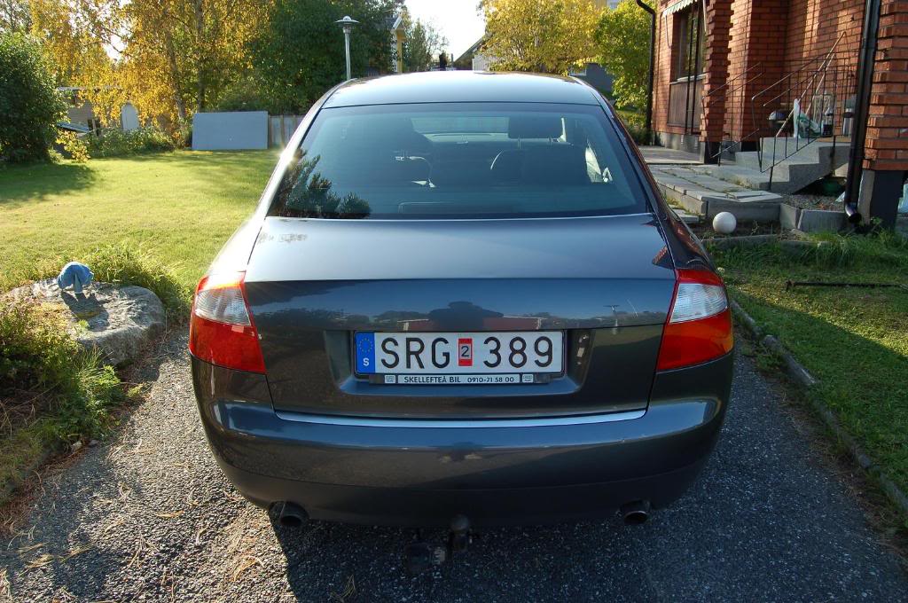

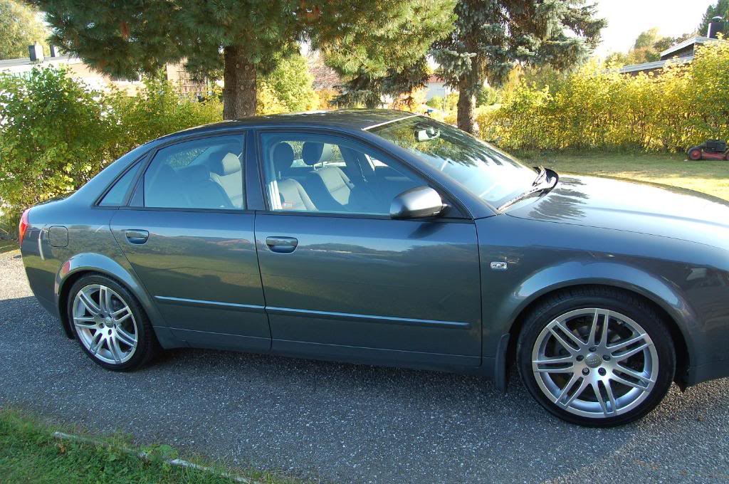

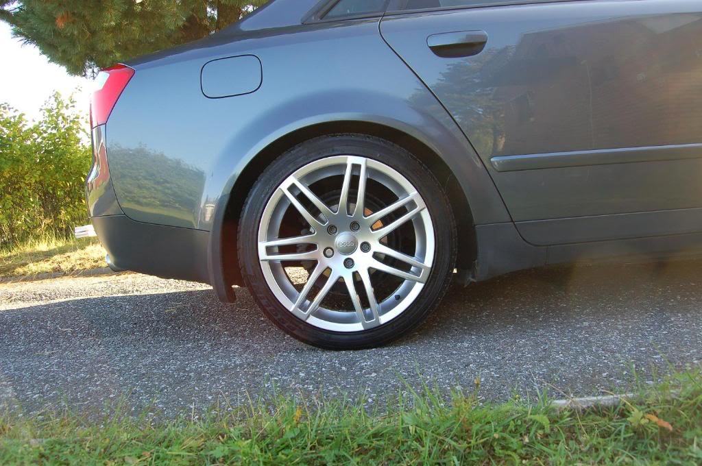

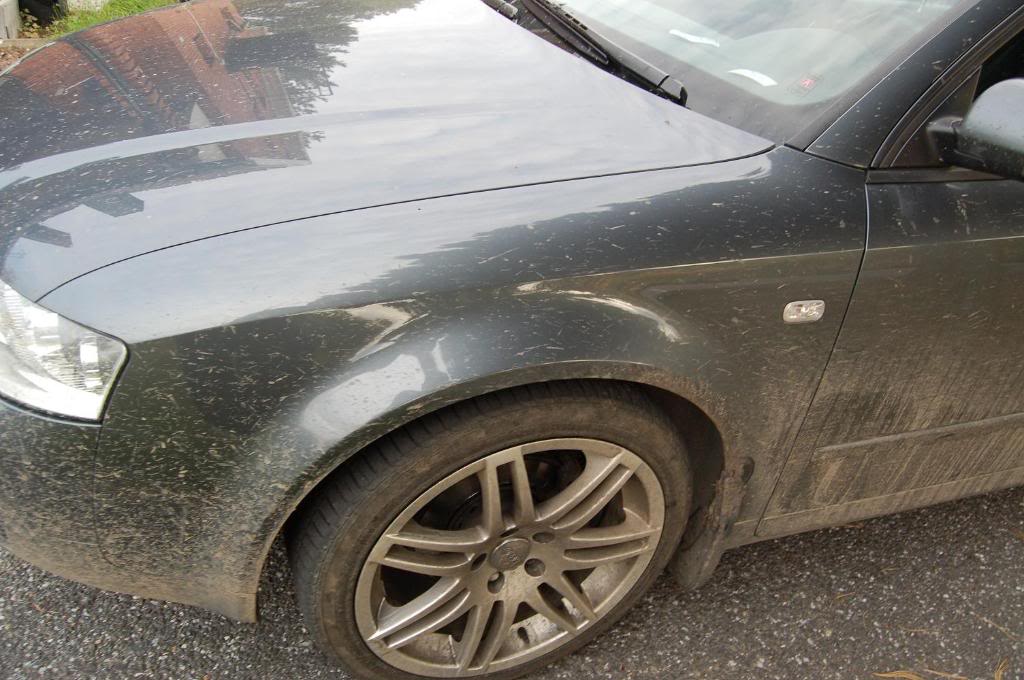

Audi A4 -03

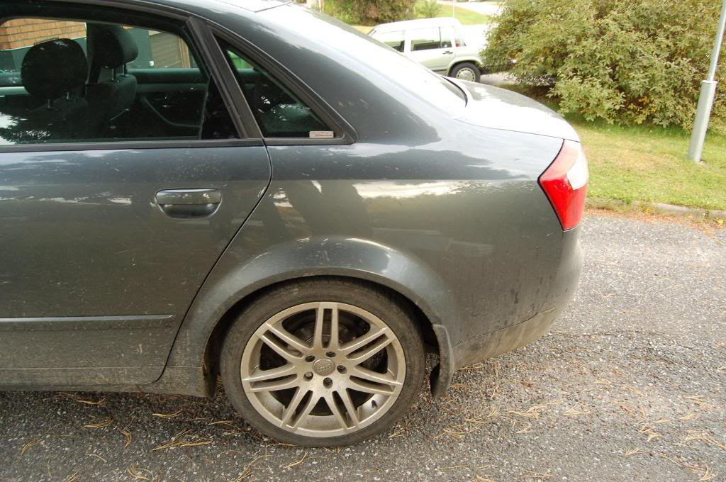

BEFORE
AFTER
This was a wash, clay and sealant.
Same prepp as above, but the LPS was applied with rotary and a finishing pad @ 900 rpm.
