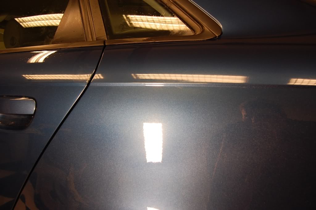

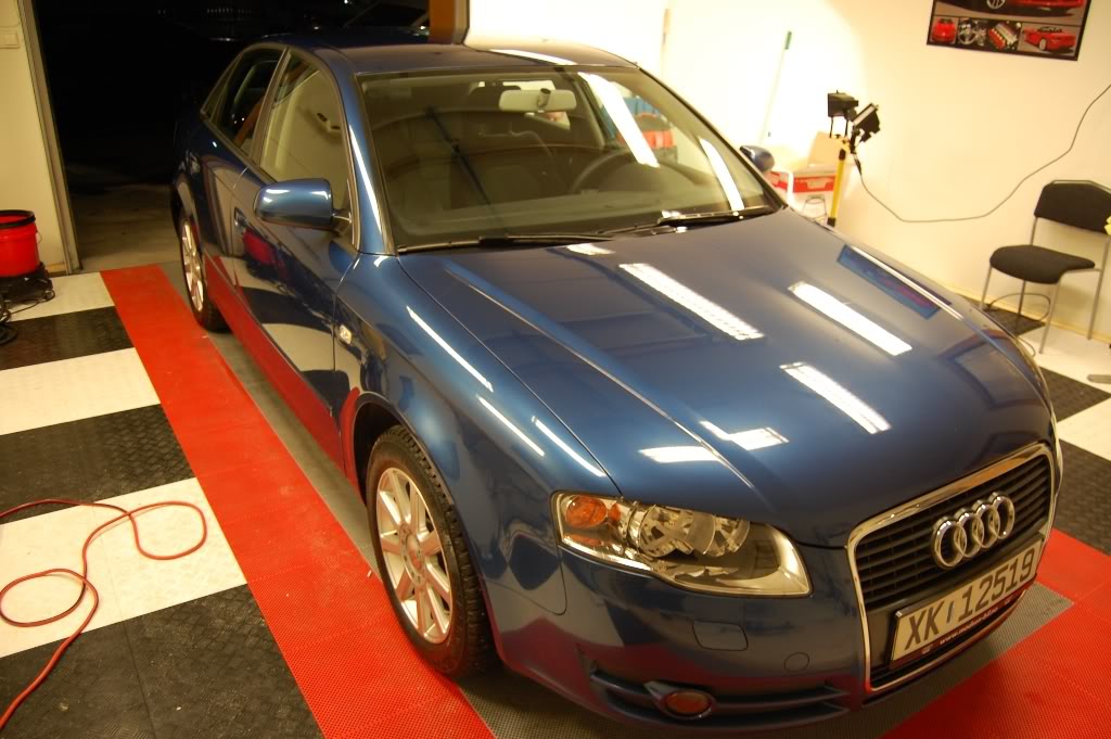

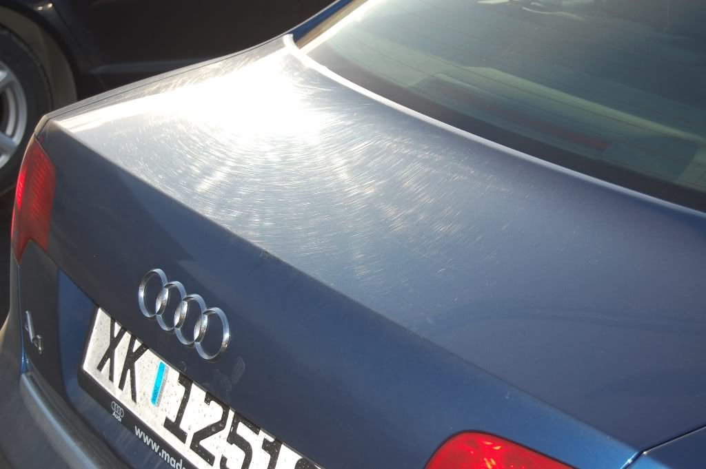

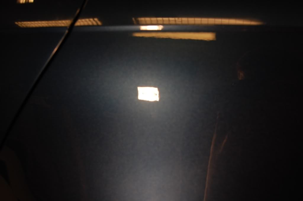

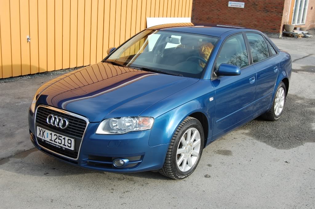

So I got this car on friday, same day as I had the renault. The car needed to be finished before saturday at 8 AM. I had to deliver it at the airport 10 AM for the customer. The car was one of the old audis from the driving school. The paint was BAD. The worst paint I have worked on ever. I had to bump up to Lake country yellow css pad and Menzerna powergloss. That says everything.
Enjoy. It was a hard day. I finished around 2 AM.
Wash:
Chemical Guys total interior cleaner
Two buckets with Chemical Guys CWG
LC mitt
Swissvax wheel brush
EZ brush
ARO

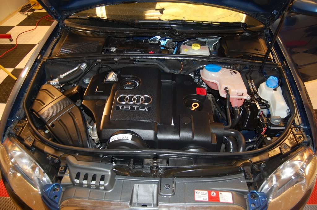

DP engine degreaser
Dehydrator for drying
Paint:
Riccardo clay
Menzerna Powergloss w/ LC yellow pad
Menzerna 106FF w/White sonus pad
Menzerna 85RD w/blue sonus pad
Swissvax cleaner fluid
Swissvax best of show

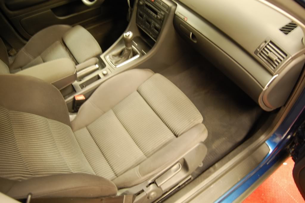

Interior:
Vaccumed
Extractor
Optimum protecant
DP krystal vision glass cleaner
Chemical Guys stain extractor
Chemical Guys leather scent
Extras:
Chemical Guys VRP
Brinkerman

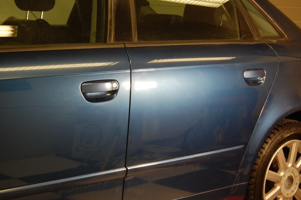

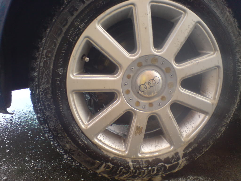

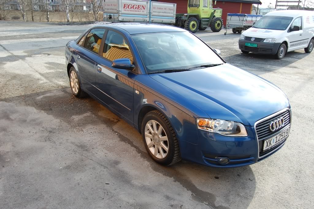

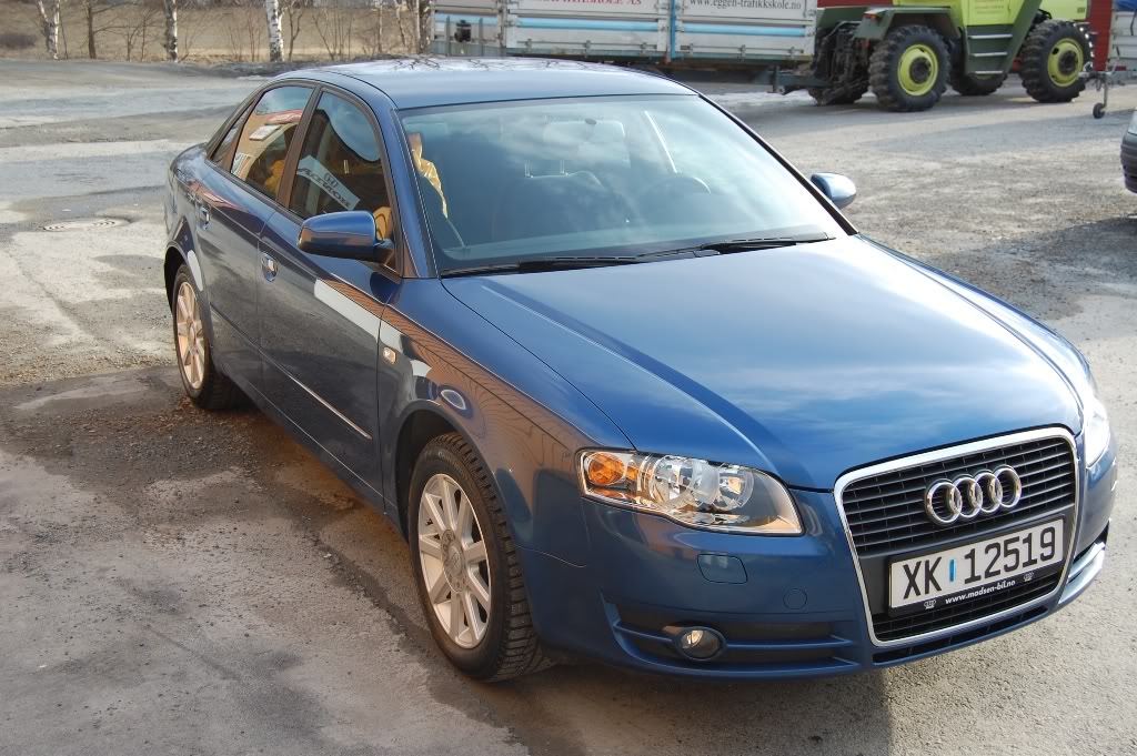

Before:
After wash:

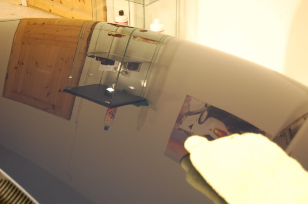

Inspection:

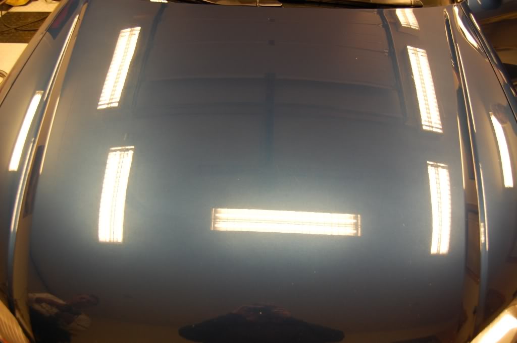

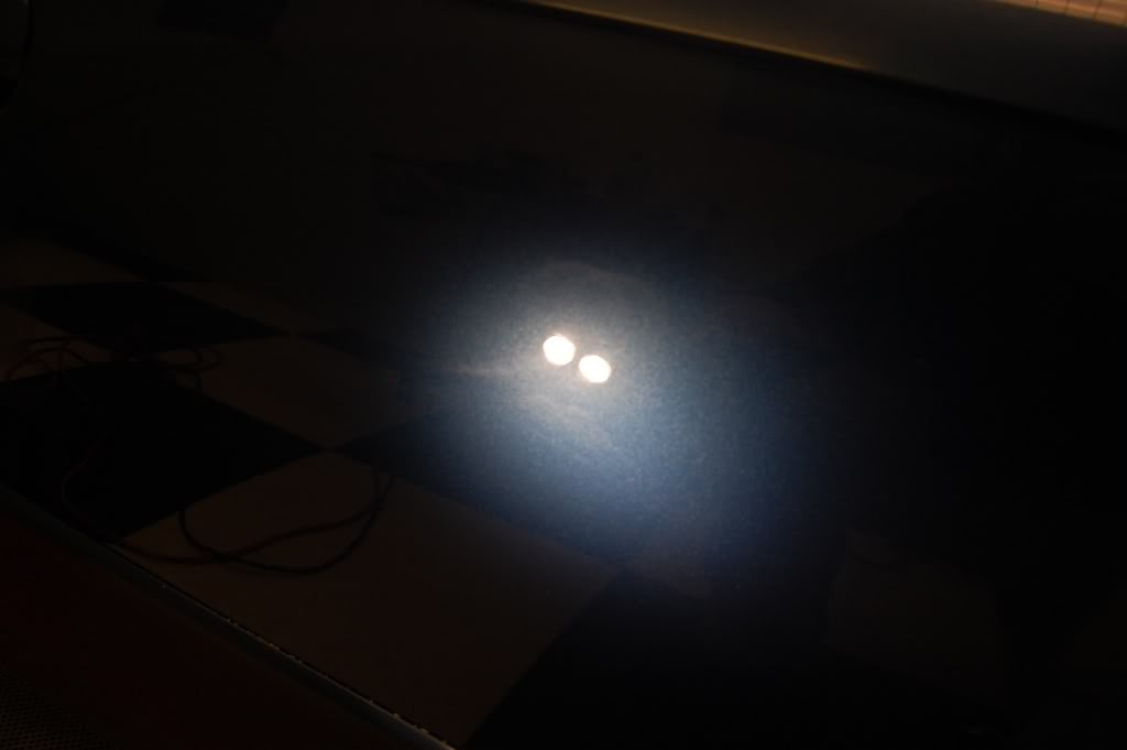

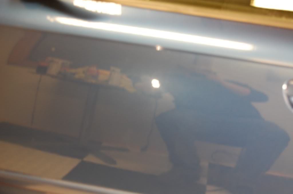

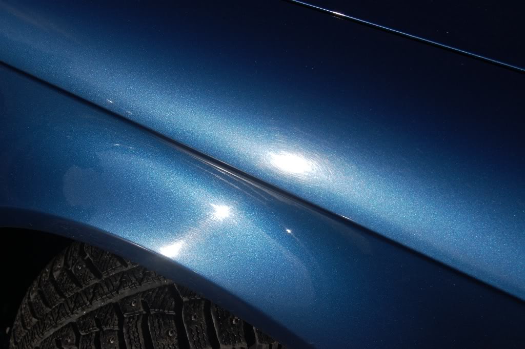

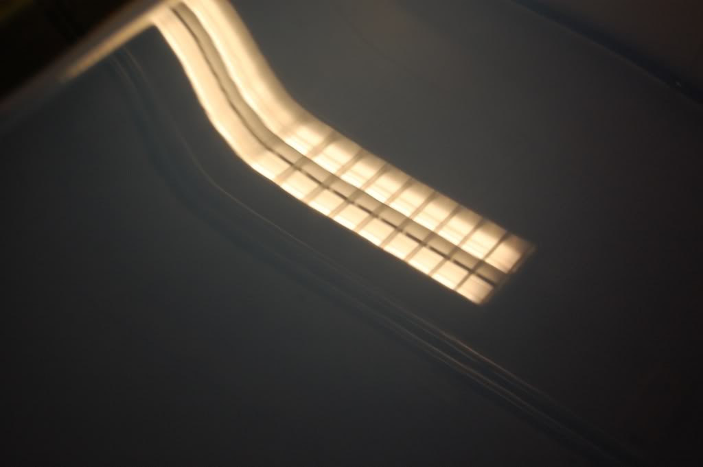

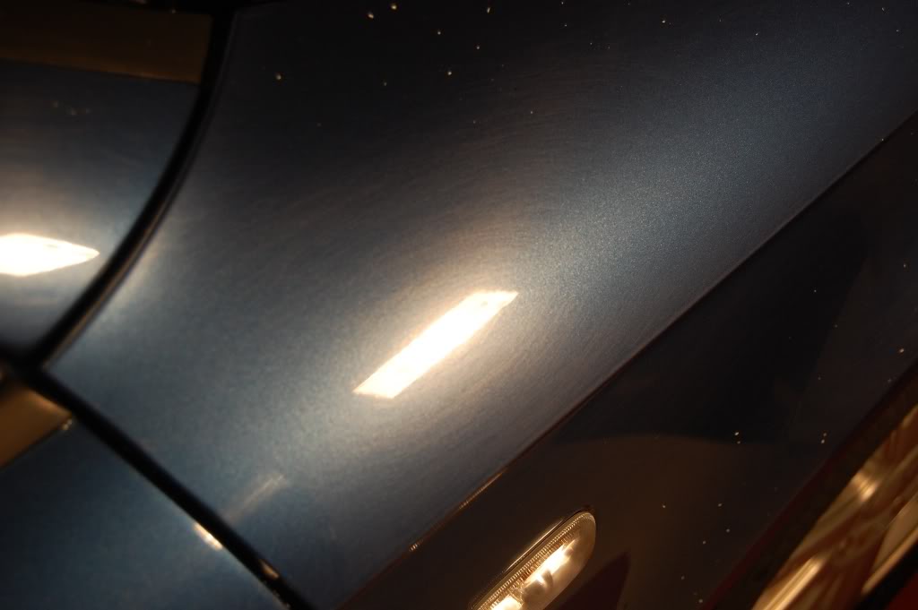

50/50:

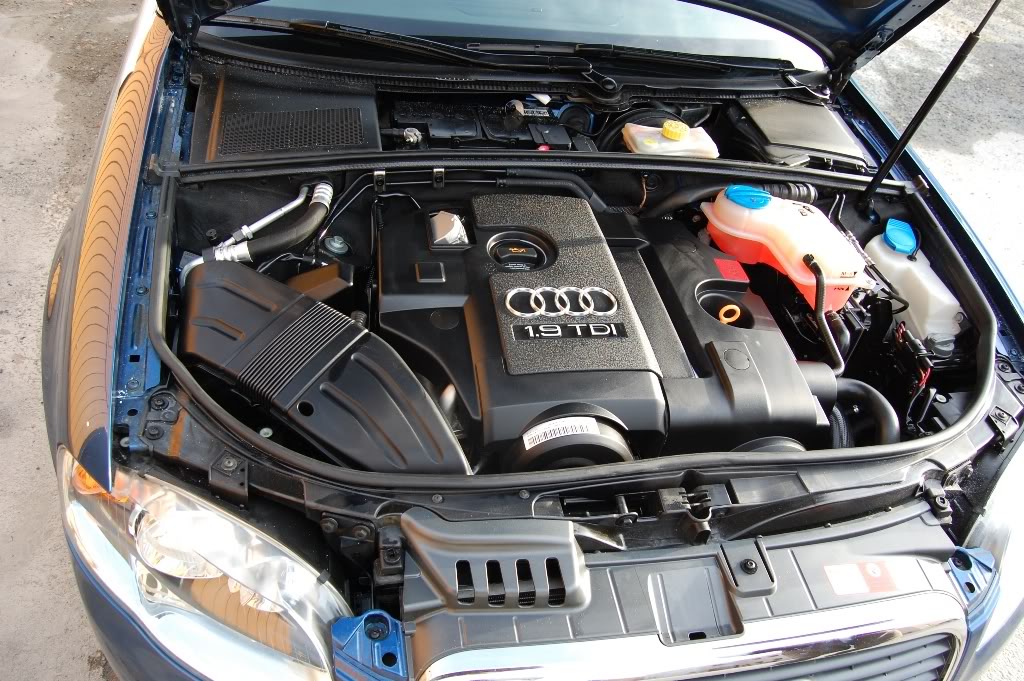

After on engine:

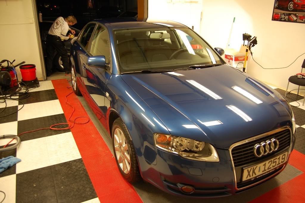

During:

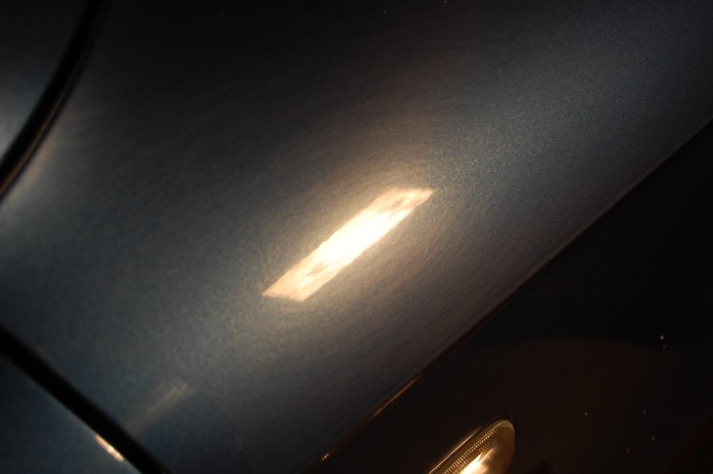

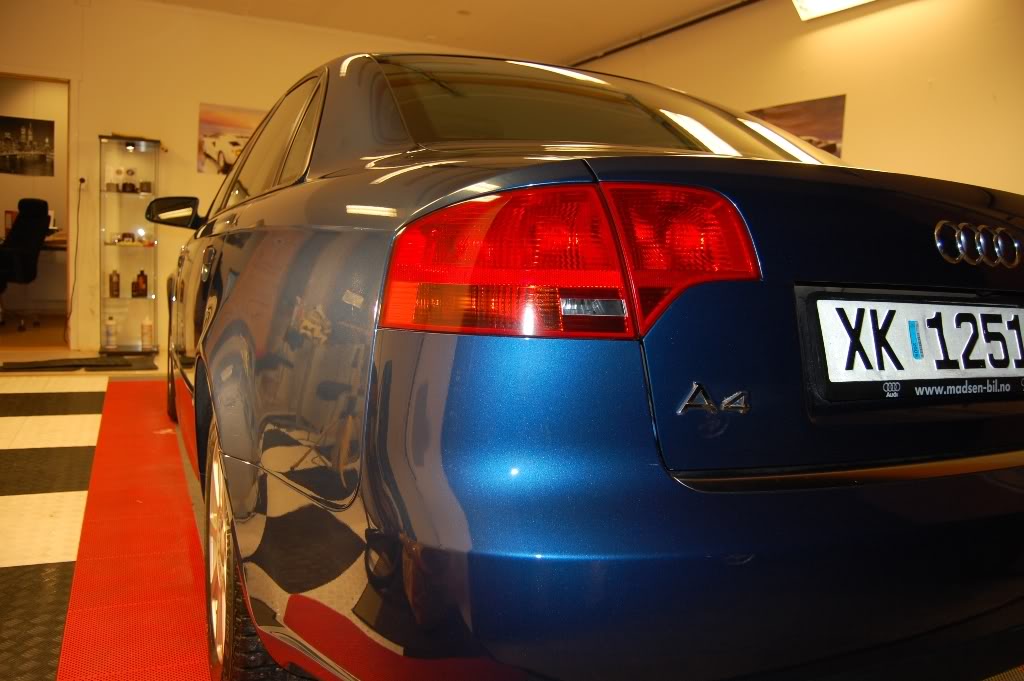

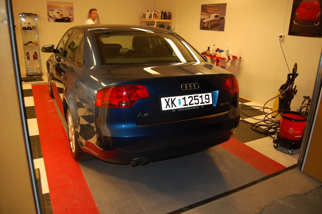

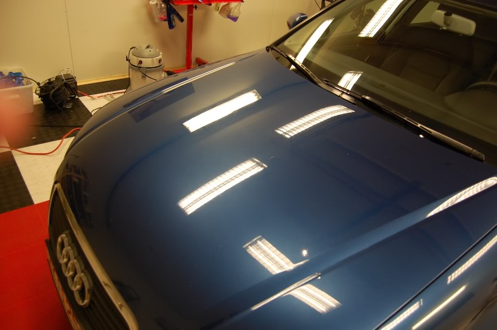

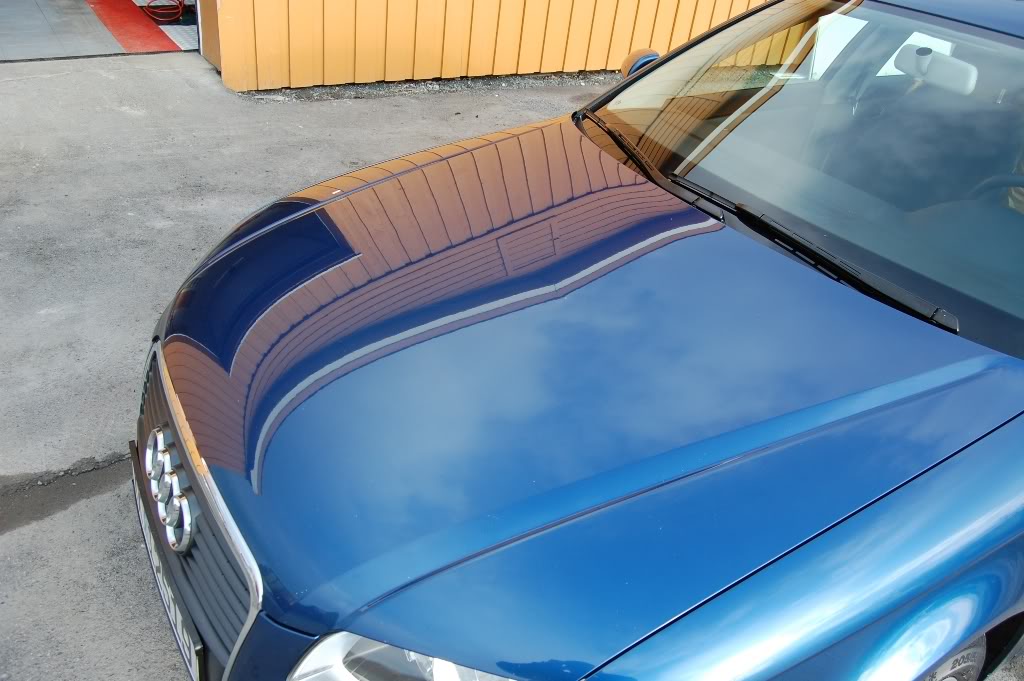

After polish:

Ser kanon ut dette....
gikk mange timer?

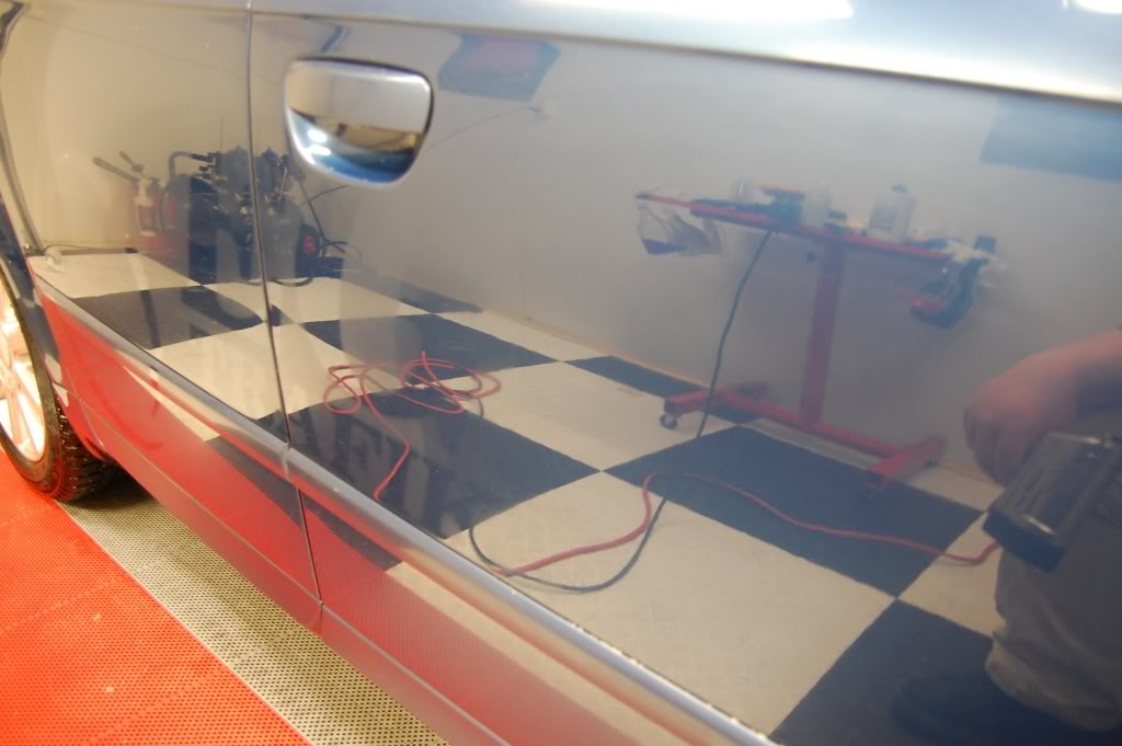

Ja Audi lakk er hard, gul pad og Menz PG kutter greit det.
Lær faren din riktig vaske teknikk av bil.....vel foresten ikke lær han det, da får du mere jobb...;)

Imponerende, syns det skriker maskinvask av de ripene jeg! :S

Collie: Sliten børste + stor bøtte + ZALO.

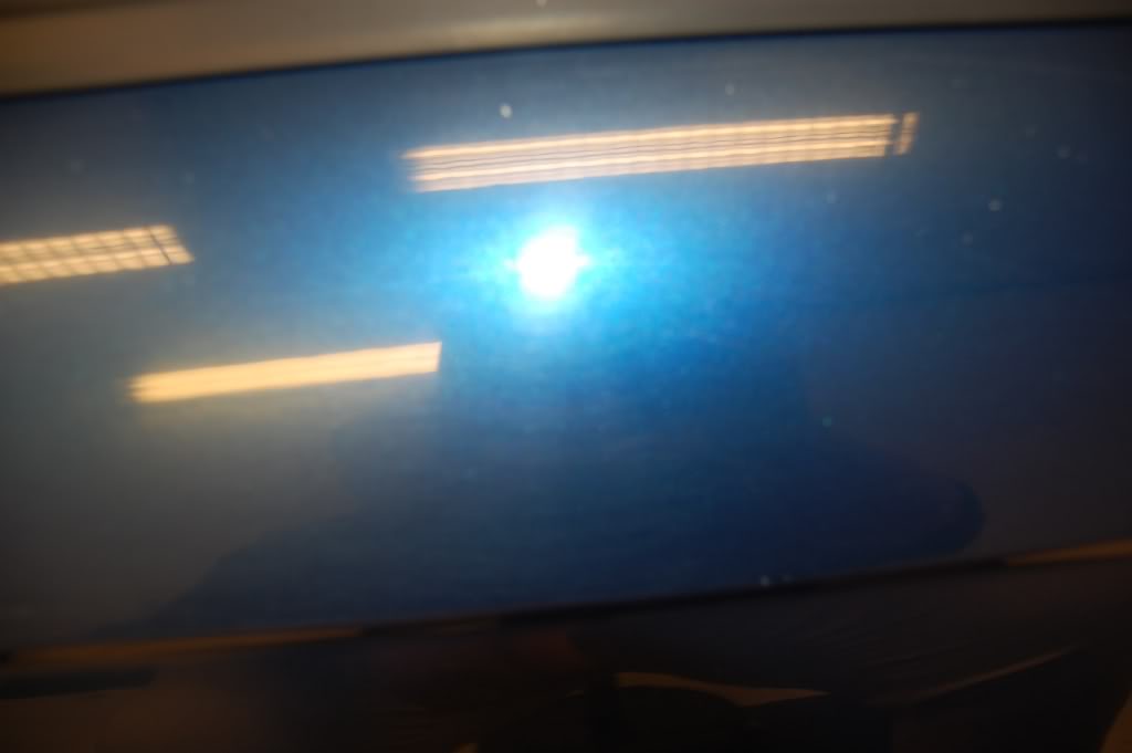

Grei å bruke til inspeksjon av lakken?

Den er litt stiv, men jeg liker den sånn. Personlige preferanser tenker jeg. Men de må nesten være såpass når de skal være grove. Man kjenner jo at den hvite osv er mykere.
